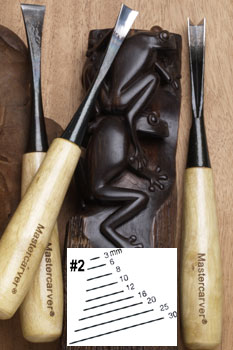

My first thought is to turn a handle similar to what many small to middlin' gouges and chisels have:
That have a slight flat spot for "registration" (so you hold them the same way every time after a few uses) and to be less prone to rolling. If I do that, is there any sort of magic formula for finger length to best diameter?
Other profiles you might suggest? I am mulling the idea of going a little long so I can do the two handed relief technique (rock the baby :) ). I also plan to leave a flat spot for occasional additional light persuasion. I harbor no illusions about making them mallet tools, but sometimes a tap is a lot easier to control.

I don't have any pictures but have customized several of my gouges with new handles. I turned handles with a small lip above the ferrule and a handle that was tapered...smaller at the base. The end was slightly rounded for comfort but flat enough for a mallet. After the handle was fitted, I sanded a flat spot on the lip to keep the gouge from rolling. To size the handle I just found a dowel or handle that felt good in my hand and copied it.
As for the length, make it an inch longer than your hand is wide and you will have plenty of leverage and it will give you more control too. This will also enable you to use the gouge by pulling it towards you and use it with two hands. On some of my wide rough out gouges (25 to 30mm plus) the handles are 12" to 14" long to give me more control and enable me to use my entire body weight to push it through the wood.
Hope this helps.
