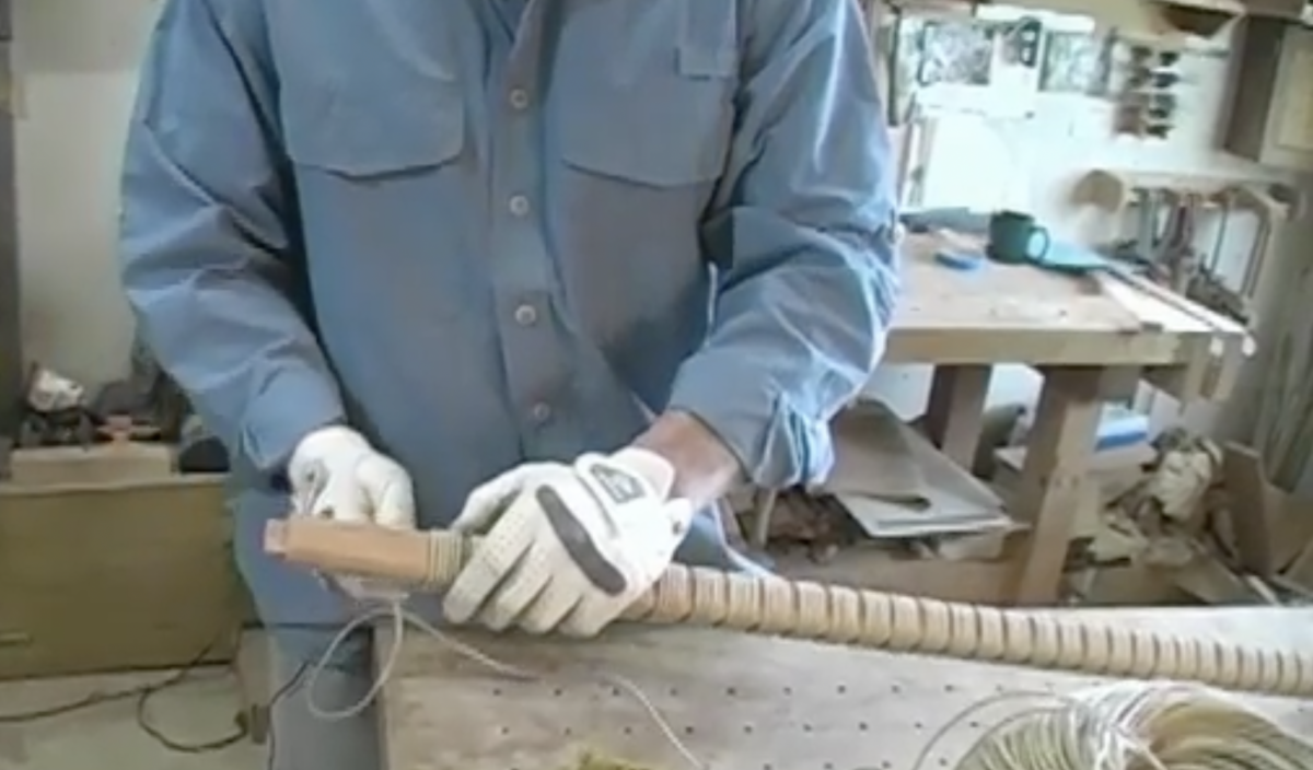

I'd be interested in how you did the weaving.
Very nice project.
There is some info on youtube but this helped:
this is the behind the paywall at FWW but i also used it:

i did a test "bench". a footstool size bench made of scrap pine put together with screws. after you do it for a while you start to see that there are nuances to getting to the cord to lay down flat and not cross over. that may not mean much but what i mean to say is...far from a high class weaver and could do much better if i did another project. you just have to try it.
