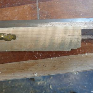

Here is the side of the stock called the cheek piece. This is the wood before carving.
In most cases in the 18th century, carvings were from ideas that builders saw in nature. In this case I chose to carve a floor stem and petals. The hardest part of carving a gunstock is working on a curved surface and holding the wood steady. I am hoping to make a giant leap in this area after building a vise with another member in June.
