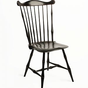

Turning legs: start out with an easy format and take it up slowly. Here you see a seemingly simple pattern but it quickly looses its appeal if you make it too fat. Notice all the legs and stretchers on the wall in the background?
Here you can see all the curves: beads and coves is all it is but it takes a good while to get confident.
