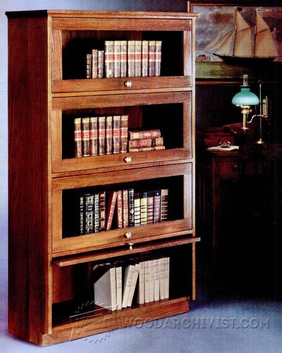

I have installed a 'built in' shelving unit, and now want to install a door on the lower shelf. Seems to me like the best choice is what I would call an in-swing door (upswing?), like that on a barrister's bookcase. This is an inset door, but it is not hinged; the top of the door slides to the back of the cabinet while the door is lifted. That's the best description I can come up with.
What I am wondering is what hardware is used for this application.
- Is this simply a pin running in a track, and if so how does one prevent racking or twisting the door enough for a pin to come out of the track?
- Or is there more sophisticated hardware available?
Never used or even looked at one, Anyone have one they can examine? Please advise.
Thanks

Henry,
Are you referring to something like in the picture below?

Also called flipper door for vertical application. Rockler has plenty of choices.
Yes, thank you. One of the first challenges in a project like this is knowing the right terminology. Hard to search well if you don't know the terms to use.

Having been through a bit more searching, including VanDykes (where the listed instructions were simply a parts diagram...), I searched the term 'flipper door' on Lee Valley (another great source of hardware). Calling them (that is LV) I was provided answers all my questions and I am likely going to implement their Concealed Door slides, with a set of soft close Blum hinges (as suggested by customer service). Total hardware costs are about $35 plus whatever shipping costs, which is more than the least expensive option, but significantly less than the bigger package deal at VanDykes.
- LV Concealed Door slides: Concealed Door Slides - Lee Valley Tools
- the associated hinges also needed: Blum Self-Closing Clip-Top Soft-Close Hinges - Lee Valley Tools
The reason that LV customer service suggested these specific hinges is that rather than mounting the hinge base directly to the cabinet, these hinges have a mounting plate that is first installed and then the hinges are slid onto these plates. This eases the hinge installation, and that was a concern; I will have my head inside a cabinet and the rest of me inside a too small bathroom, and will be installing top mount hinges. Ease of installation will make a difference here, even though this is a one-off.
I have not yet determined the final dimensions of the already installed built-in cabinet (opening for inset door and depth of cabinet), but will update this thread when I manage to finish this project.
