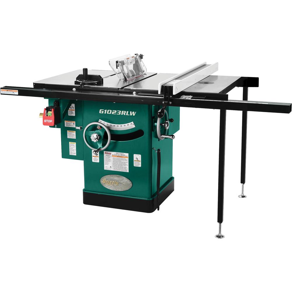

Thanks for the pointer to the Grizzly. I will have to call them tomorrow to see how much additional freight to get one out of Washington, as they are not in stock in Missouri.

I own a Grizzly table saw (found it used) and have had good service with it. Only to see the curent Grizzly offerings I went to their home page and the image below popped up. That would help with the shipping cost.
