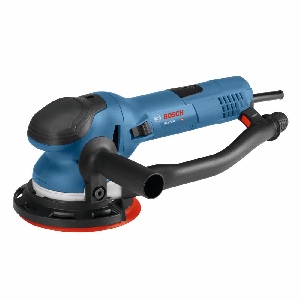

I'd consider the Bosch GET65N or 75N (5 and 6 inch dual action orbital sanders). I have the 65N. I've considered also picking up the 75. I have no complaints at all about the sander and in my opinion it compares well with the festool sanders it competes with. I generally use it with 3M cubitron mesh sandpaper and a festool midi dust extractor. It does an excellent job with dust collection and leaves a great finish, and the turbo setting can really hog off wood.
If you're not averse to factory recon tools here is a six incher for $210.
