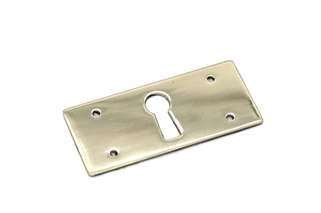

Beautiful work. I am curious about the brass keyhole. Did you make that or do you have a source?
