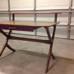

It depends on the stress applied to the joint. I have used Domino's for conventional joints i.e. standard tables etc. and had no issues. Typically the stress on a "normal table is equally distributed across all 4 legs.
However, I made a Maloof inspired desk for my daughter (the photos of the desk is blow). The rear legs were angled and curved so all of the stress was on the two back legs. I used two Dominoes in the joint for these two rear legs as it was much easier based on the design of the desk. It was partly poor design as all of the weight of the entire desk was shifted to these two legs. However, my daughter works from home and upgraded her computer monitor to a 36" monitor which is very heavy. the result was a failed joint over about a year. I was able to make a repair by removing the legs, reattaching the Dominoes and inlaid butterflies on each side of the joint on both legs. It has not been a couple of years and I have seen no problems.
