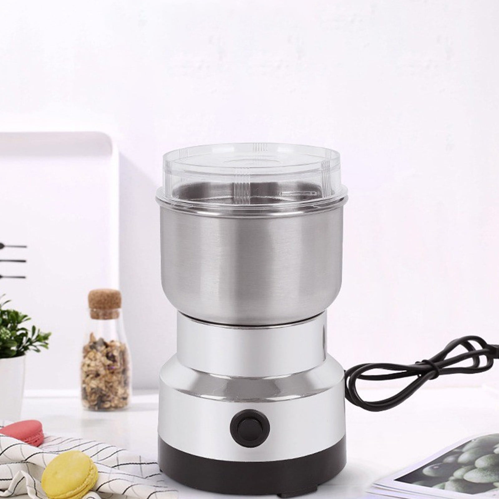

I have run into some old and not so old flakes before with the same problem. I used and old coffee grinder to get them finer and heated the alcohol/shellac in a crock pot to no avail. I ended up tossing it out.

From my experience, it takes a while (i.e. multiple hours or overnight) for shellac to dissolve, even when ground up. I have a cheap coffee grinder dedicated to that task.

My process has been to grind the flakes into a powder and after placing it and the denatured alcohol together in a sealed jar. Shake it about every fifteen minutes or so for about a couple of hours. Then let it set over night. That usually does the trick.

Like others said, just but a small blender I have a Hamilton I paid 10-11 bucks for, pretty useless as a real blender but great for making flakes into powder, just follow Graywolf's posting.
One other thing limit to 2 lb cut as the max concentration until you are more familiar with the process.
