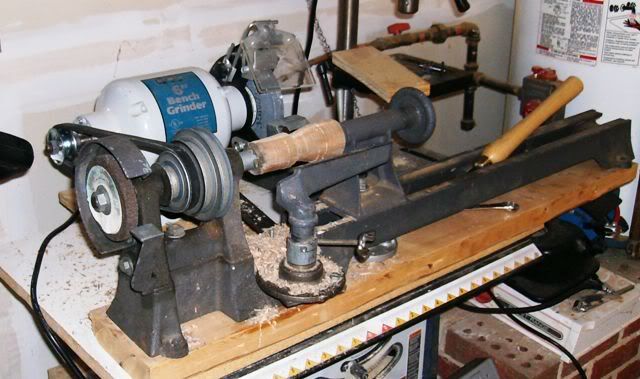

It's the one I posted about possibly cannibalizing and then powering with a grinder. It is powered with that for now:
The grinder is mounted on a hinged platform and I can move the belt to the next larger sheave without rubbing, so it is a two speed of sorts, but the one it is on is the right one for small spindle stuff. The tool rest is courtesy of Fred :eusa_clap.
That's just a chunk of firewood that I cut a small blank out of.

Looks like you could sharpen your tools without shutting off the lathe....how efficient :icon_thum

Yep - even if I was using a better motor and not just a grinder. I left the other wheel on the grinder as a flywheel - keeping the momentum going once it gets up to speed. Interestingly enough, that old small wheel on the lathe seems tobe a higher quality stone than the ones on my $20 Big Lots grinder; I am sure you are shocked. :)
I don't use the Big Lots grinder at all if it is hooked to the lathe and I turn it on and off with a switch on a power bar rather than reaching across the spinning workpiece.
I do plan a motor upgrade, but I am waiting until after the holidays in case Santa replaces that piece of garbage I drill holes with (you can just make out the post, table and chuck of the DP in the upper right). The motor is fine; it's just big enough for some things I need a DP for and it has a little play in it.
