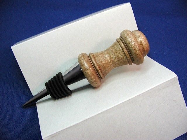

Everybody who responded pretty much covered it, so all I can do in excess is add some examples/ideas...hope this helps (from last Christmas):

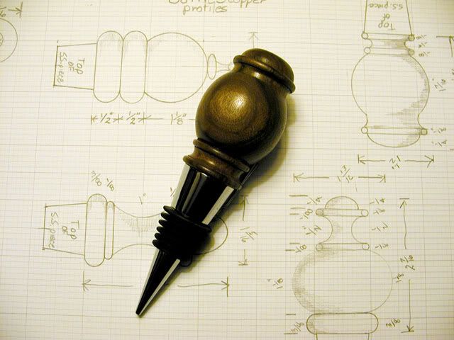

Doug... I only started making stoppers about a couple months ago out of desperation for more stuff to use my lathe for. Wanted them to be a little more unique than some of the stopper patterns I saw inthe books so I drew up a couple patterns of my own. I too use the mandrel from PSI but don't thread the wood. I turn the mandrel and stainless piece directly into the wood I turned for a super tight fit. The bottom section of the stoppers from PSI unscrews itself via machine threads so you can put the stainless part, minus the wood into the dishwasher or sink to clean.

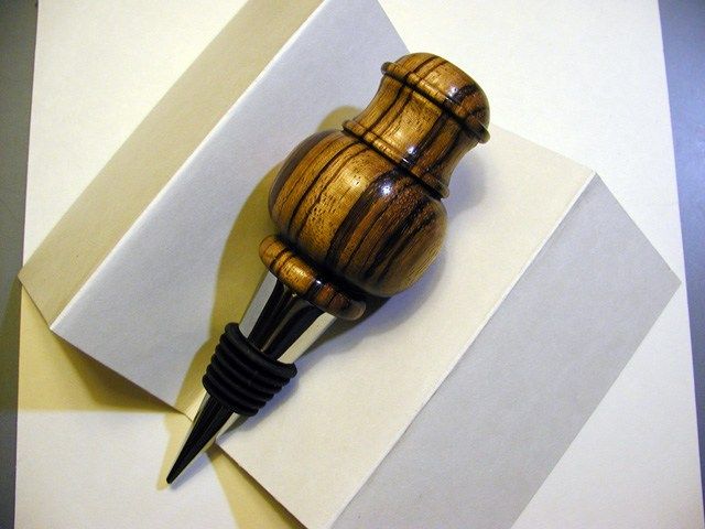

This is one I have just taken off of the lathe I enjoy these and I have sold 14 so far this year. If you turn a few have fun and let your mind just go wild and find your own designs in the wood
Thanks Mark
