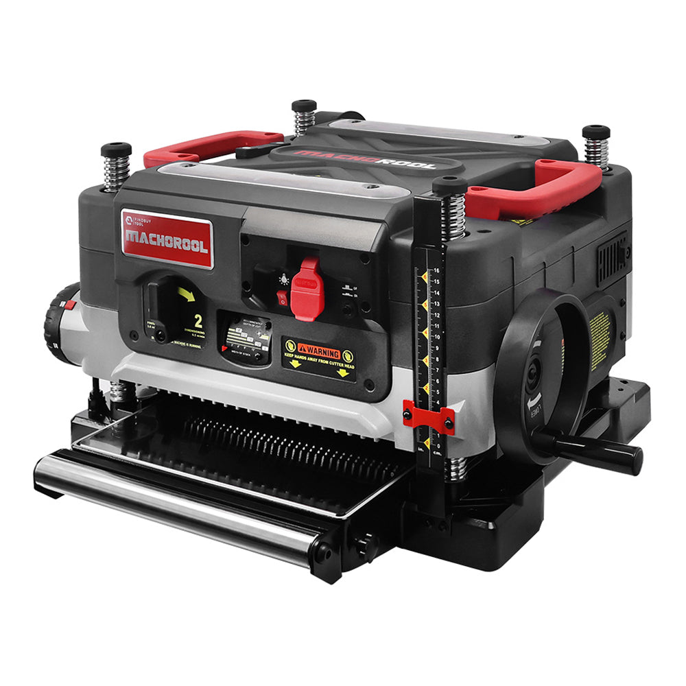

I've not needed to use my planer since my last comments unfortunately. I did see recently where they now have their own version/copy of the DeWalt 735X with their helical cutter installed, longer beds (just a roller that extends out farther) and an elbow for the dust collection at a lower cost than the DeWalt w/ helical cutter. However, if you're here then you have a planer and just need the cutter head swap.
